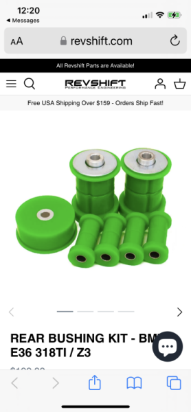

I’ve been reading up on this as well and will be following this thread closely as I’m in the same situation. I have a 97 2.8 and purchased this rear bushing kit from Revshift earlier this morning. From what I’ve learned, the rear subframe bushings should be a priority due to the common diff mount fail that can happen on the 6 cylinder cars. (Poor explanation but you can learn more in the forum). I bought the black 80 version rather than the green 95 for a sporty but softer ride.
