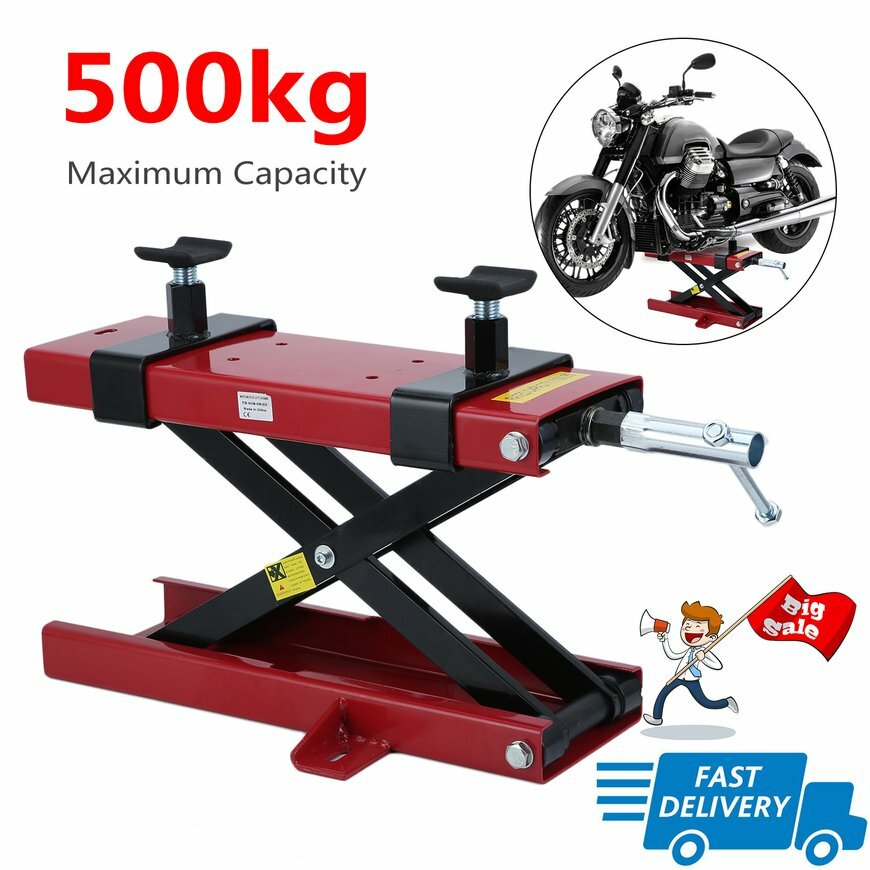

I'd asked Father Christmas for one of these last year with gearbox and diff removal in mind. They are about £30 and to cut to the chase it worked like a dream. I didn't use the cradles.
So I jacked this up under the diff to just start taking the weight. And undid the hanger bolt. I then lowered it enough on the jack to remove the four bolts securing the diff to the beam. These sit very high and you won't get a tool in without doing this. I used a ring spanner and heavy lump hammer as the bolts are on tight.
At this point the diff is almost free to drop but needs help off the end of the propshaft. It will need to go lower until it clears the hanger bracket on the floor pan. By this time I was hearing some distressing noises as I'd forgot to remove the heatshield but the only damage was to the heatshield itself and this can be fixed. The propshaft is capable of flexing down some distance to help with this step. Once clear of the mounting bracket the diff can be wiggled backwardwas until it breaks from the propshaft. This step was a little more tricky than I expected and did need quite a bit of persuasion.
And can then be lowered to the floor. Being an LSD it's heavy.
