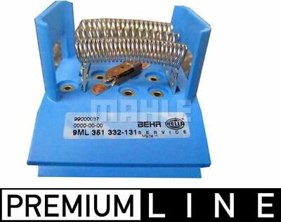

A common problem for our cars as they get older is a failed blower resistor, the symptoms for this is the fan only works on speed 4 (max). The blower resistor comes as two different parts depending upon the specification of your car.
If your car has air conditioning, the blower resistor is located outside the car under the windscreen scuttle panel.
If you car does not have air-conditioing the blower resistor is located within the cabin behind the panel on the right hand side of the passenger footwell. (RHD Cars)
You can see below that the resistor part for Air-con and non Air-con are different.
Blower Heater Resistor Non Air-con - 64111375754 - Part 3
Electric parts for heater -
BMW parts catalog
Blower Heater Resister Air-con - 64116912633 - Part 4
Electric parts for ac unit -
BMW parts catalog
