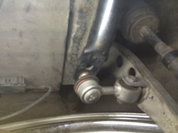

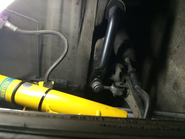

1998 pre-facelift 2.8: I have just fitted a new set of Bilstein B6's and they feel much firmer than the B4's and would not want any firmer on the road. I have had a set of front & rear H&R Anti roll bars fitted & they have always been on the outer (softer) of the two settings. Today, I tried to adjust the ARB's to the inner (firmer) of the two settings but could not... We could not force the joints far enough over and seems the joints would touch/rub against the subframe if we managed to ... The pictures below are on their existing softer settings. They are supposed to be the correct ARB's for my Z3 & indeed they seems to be. So why can't I adjust them ...am I doing something wrong? seems the existing ball joint cannot be used for the firm setting because you would need to force bend it too much... has anyone fitted a set of H&R ARB's on the harder setting? would appreciate any tips/photos ...thanks
