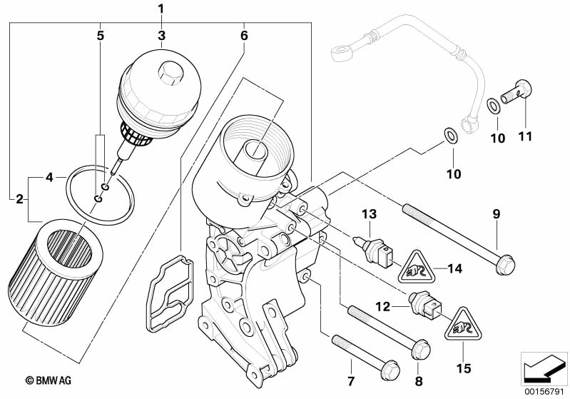

Start the engine to warm the old engine oil which ensures it comes out easier as it’s thinner inconsistency.
Lift the dipstick to enable the air and the oil out easily.
Loosen the oil cap.
Jack both front jack points so the car is elevated up.
Now remove the oil sump plug ensuring the collection tray is in the correct position @Grumps
Remove the seal from the top of the oil filter housing. Drips occur of the old oil.
Clean the oil filter cap with multi-purpose cleaner (brake clutch cleaner).
Pop the spindle and cap back together and then add the oil filter and seal.
Rub a little of the new oil around this filter.
Use a 36mm socket on a ratchet to tighten the oil filter.
When all the oil has fully drained out of the engine, refit the sump plug with the new copper washer.
