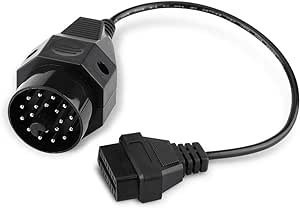

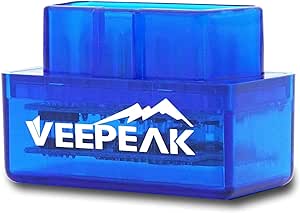

Hey , i have a 1999 year 2.0 6 pot still obd1 most of the info is from the port under the bonnet , nothing from the obd2 under the steering wheel
need to diagnose a abs light fault nothing showing up
I use the Veepeak OBD2 reader (in conjunction with a Car Scanner ELM free app on my phone,) and a simple BMW OBD1 to OBD2 adaptor. That way you can read all the info from the OBD1 port properly. I paid a one off fee of £4.99 to upgrade the scanner app to the pro version to unlock everything. Stores multiple cars in its profle for you and retains all their reports and readings. Plenty of Youtube videos on it like this one (503) This $5 OBD2 app can code ECU | ELM327 - YouTube
Dont use Carly! Has a subscription fee every year of about £70 and is massively being promoted everywhere, total rip off.
The Veepeak is £15 and the BMW OBD1 to OBD2 adaptor is £10 from loads of places like amazon or Ebay. In total I've spent £30, no subscriptions and reads everything you'll need. Download links for the scanner app below - Android and Iphone:
Car Scanner ELM OBD2 – Apps on Google Play
Car Scanner ELM OBD2 on the App Store (apple.com)
The OBD2 port does give info, but only engine and auto transmission ECUs.
