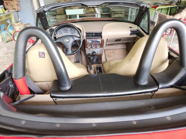

As title, promised for a member on here.
The last one of these I did the photos disappeared thanks to photobucket.
No need to remove the seat, I just happened to have it out already.

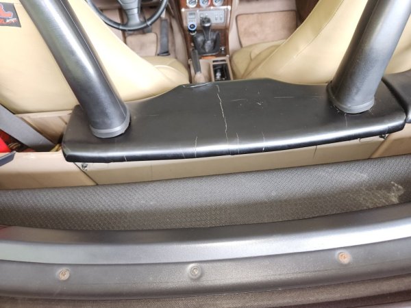

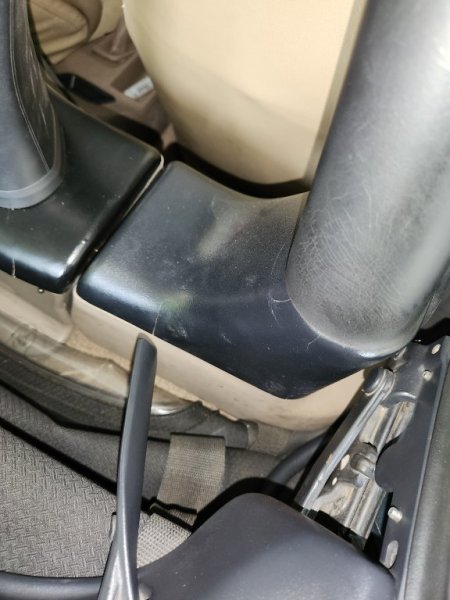

First you need to get the hoops themselves off. You need to gently prise these covers out, the ones in the storage box you push a screwdriver in the square hole and pull upwards, otherwise you’ll bend the clips.
Then use a T40 torx bit to remove the 6 bolts
Then pull the hoops upwards
Then pull the inner leg covers off (clips only)

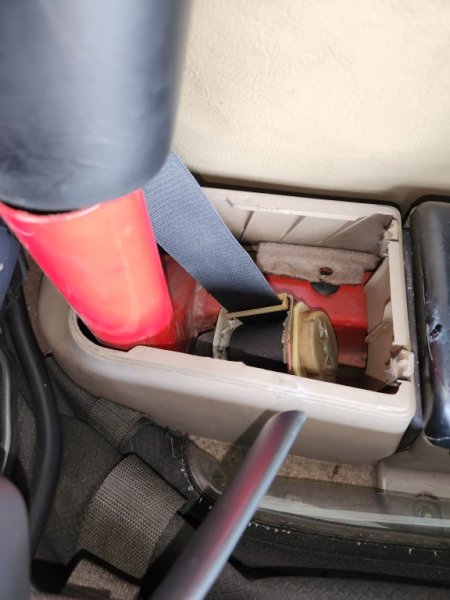

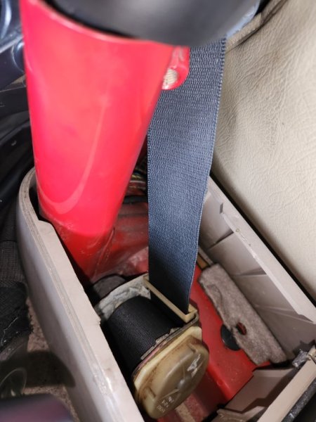

Then you need to get the storage box out, just 7 Phillips screws, one each side tucked deep in the cavity. The little ones don’t need to come out.
The box lifts out
Then remove the turret covers and speaker panels, all Phillips screws, plus the 16mm that holds the seat belt onto the seat.
