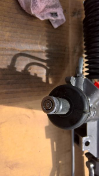

1.9L Z3
This is what mine looks like, I don't see anyway it can have a master spline. I managed to force a screw driver in the gap, but it doesn't seem to have made it any easier.

Make sure the clamping bolt is removed before refitting as it won't go on if it is fitted.

I finally got it! Thanks for the ideas.
I hammered a screw driver into the little crack then continued using that screw driver as leverage to hammer the spline in. It took hours and half a can of WD-40 but it's in there now.
