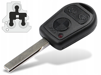

Try this guy if you dont have the actual key code available & dont want to send it away. I dont have wifi on mine so should be fine for me.
