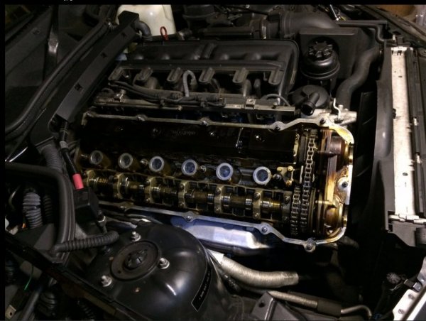

When under the car refitting the front bumper, I noticed a slight oil leak from somewhere higher up. Closer investigation showed that it was from the head cover gasket. It was not bad enough to have caused a drip yet but I thought it would be worth fixing. I got a new gasket from Sopers and removed the head cover, the gasket set consists of a moulded rubber outer gasket and two moulded rubber inner gaskets which seal the spark plug tubes. I was surprised to find that the old gasket was completely hardened, obviously the result of 101,000 miles of hot engine. The plug tube gaskets were rock hard and starting to break up.
This is obviously worth checking on higher mileage engines as, if left the oil will eventually leak into the plug tubes and cause problems.

Sound advice. What was the cost and how long to do?

The gasket set was £42 and it took about 3 hours but that was with a learning curve. It would take less time to do it again. This was the old gasket. I meant to include it on the original message but it didn't appear.

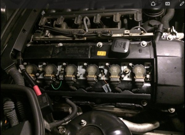

When removing/replacing the rocker cover screws a driver drill with a 1/4" socket adapter is a very useful tool. Many bolts removed very quickly. Also handy when changing spark plugs when taking out the pencil coil bolts.

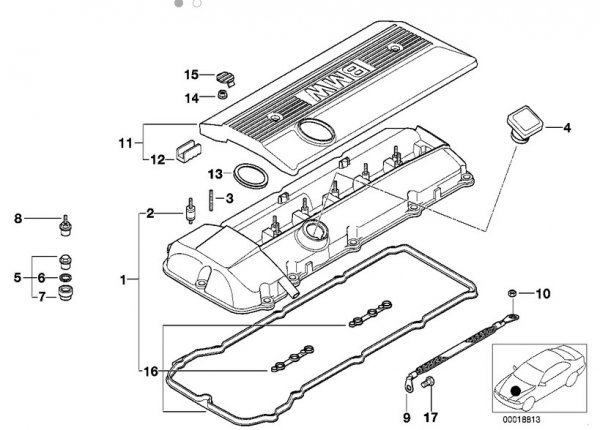

I would recommend that in addition to changing profile gaskets as above you also examine/change the rubber seals on the mounting bolts and any other `O' rings (vary with model). As @mwpe originally said they all harden over time. On my M44 the gasket was not too bad but the bolt rubbers had hardened and cracked and the O ring on the oil spray ring was more like bakelite and near to failure.
