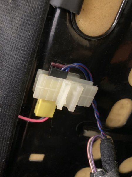

This is the connector on a pre facelift 1.9 - which I think had two airbags.

I just tried completely unplugging the module and it seems to have cleared and not returned! Seems odd to me but I’m not going to question it.

The entire occupancy sensor under the seat, black box with a white plug going in and a black plug going out.
Time will tell but cleared the codes on the diagnostics and cycled ignition and it hasn’t come back yet.

I think where mine is non airbag on passenger side plugging one in confused the module.
