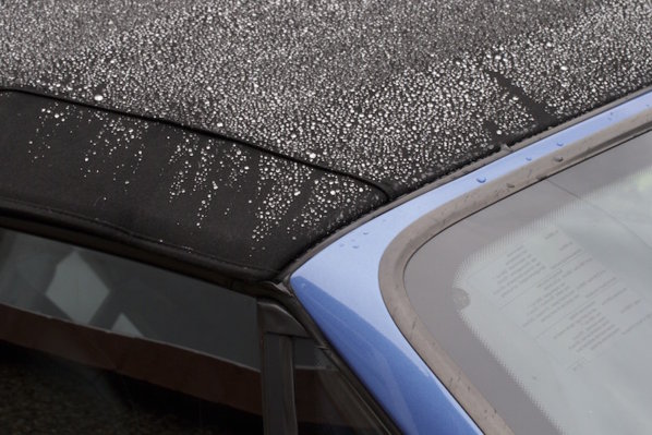

Simply outstanding - beads in style!

Just used CarPro C.Quartz Fabric on the 3series soft top for protection. Works perfect.
