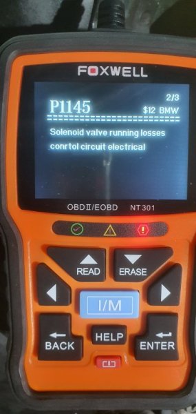

I connected it and got several coeds,
one on them was - P1145 – selenoid valve
After short research I suspired to find that I do not have this valve – LOL… it's just missing

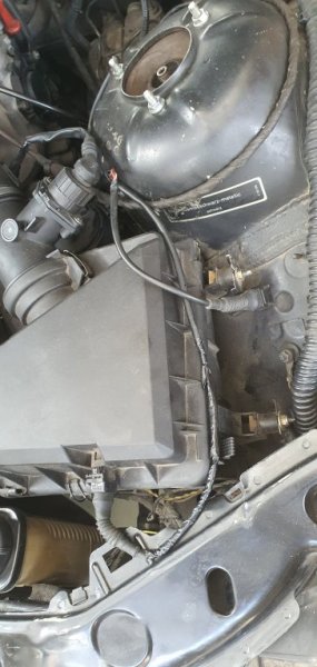

I attached photo from Haynes book (part number 4 )

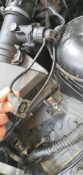

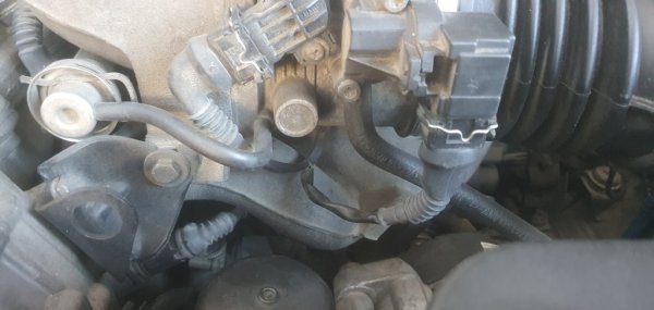

And I attached my engine… nothing there…
Should I have this valve correct ?
If so, I of course will buy this valve,
But I have no idea where I should connect that two tubes ?!

Try clearing the code and see if you get a check engine light after that.
Not sure what that valve does so not sure if you have to have one.

just did and it came back again,

What year and what engine M43 or M44 1.9

That solenoid is more for the late SOHC M43 engine. M44's don't have them afaik.
