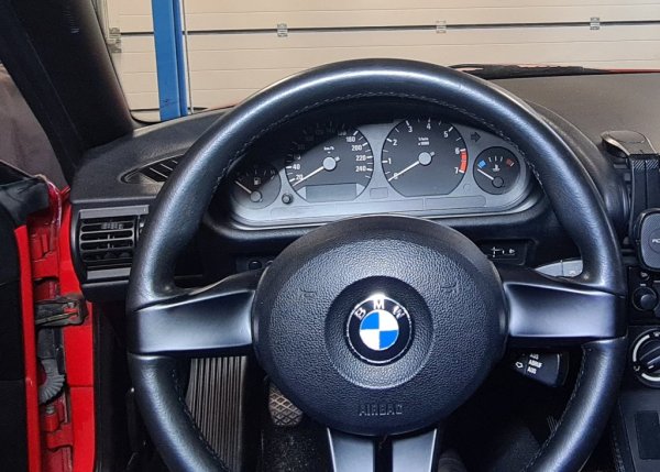

I needed a change as regards steering wheel so decided to fit a Z4 E85 steering wheel to my Z3 facelift.
Bought a Z4 steering wheel with MFSW buttons + paddles(!)

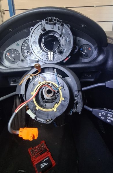

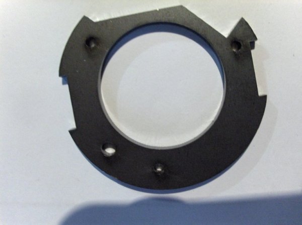

Νeeded some machining to fit the E39 slip ring (7 cables to use extra cable for light of buttons)
Soldered facelift slipring plugs for car and airbag side and a 4 pin female plug to connect to 4 pin MFSW buttons
All went as planned and voila! Illumination of buttons works, horn also works and indicators canceling works as should.
