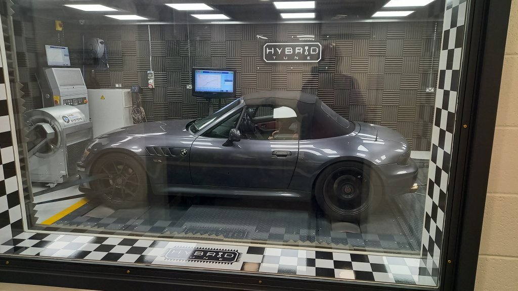

I know have 500 miles on the turbo build and its running great. Still needs its final tune at the end of the month but other then that I am happy. Other then the pops and bangs on deceleration.
Fuel consumption is not great but that's because my foot and not the car. Driving impressions are normal until you give it some pedal. I have driven several long trips now from Norfolk to Hull and back and doing four hours at a time puts some confidence in the car again after it has been in pieces.
I am also really happy with the new tires and wheels on the car. I change to Michelin pilot sports and they are night and day compared to the Goodyears on the car before. I cant say its just the brands as the size changed also but there is a notice difference in the grip. The old ones used to feel as if they would just break away and loose all traction. These are just more settled and you seam to be able to drive to the limit and they dont punish you near as much for going over. The car now has 245 fronts and 295. The rear was already narrowed with Z4 hubs and these are about the biggest I could fit without breaking the bank and starting down the road of major modifications. The wheels have custom offsets and nothing rubs.
Otherwise the car is riding on BC coil overs and all the bushings have been replaced over the last two years. Honda S2000 seats keep me in place and she has a nice new top installed this winter.
This project all started when I picked up a 330 intake manifold for more power. The more I thought about it I didnt think the amount of work was worth the return so I went further.
It was a steep learning curve but worked out in the end.
The MS43 DME running the TU engine is not supported and nobody modifies them so I had to go with a standalone. Everything works as original but I lost the traction control. I will talk with the tuners as I maybe able to wire this back in.
The other I experienced was my fault. I didn't remove the block from the car and choose to tap the turbo oil return into the boom right of the timing cover. This works on top mount turbos but my low mount didn't drain. Car smoked like it was in a 007 movie. In the end I fitted a scavenging pump to return the oil. A little noisy on startup but once the oil is warm its fine.
Holset HX35 turbo
Turbine housing Hx35 H1c WH1c Turbine Housing t3 .82
Exh manifold FTWL Mid mount
Wastegate Precision Turbo Wastegate 46mm Black PW46 PT#PBO085-2000
Blow off valve. Turbo smart 25mm plumb back
Air cooler 3" 76mm ALUMINIUM PERFORMANCE
Core Size: 445x300x76mm | Overall Size: 630x330x76mm
ECU Delta 800
MAP sensor
Head gasket REINZ 61-33070-00
Spacer 1mm
Head studs ARP 201-4302
Fuel pump WALBRO 255 FUEL PUMP
Injectors Bosch EV14 (specs?)
Wide band AEM X-Series Wideband UEGO AFR Sensor Controller Gauge # 30-0300
Plugs NGK BKR7EIX (2667)
Scavenging pump Mocal
Exhaust 3 inch down pipe splitting into a pair of 2.5 inch pipes. High flow cats and silencers.
I got a little carried away and fitted this all before doing the rear subframe. I will keep an eye on the spot welds and then stiffen it up next winter.

Been awhile but the car is still running great.
I am working away for awhile so I dropped it at the tuners this weekend so they could could spend more time on the cold starts and just just clean up the tune. It's running and starting but a bit rich when cold.
I do have to say a very wet cold day in January is not good for me. Just wanted to see how it was running so looked down at the boost gauge for a second while I gave it some throttle. Even in fifth gear summer tyres don't hold and I got very excited for a for more then a moment. Its insanely fast and much more fun in the sun.
