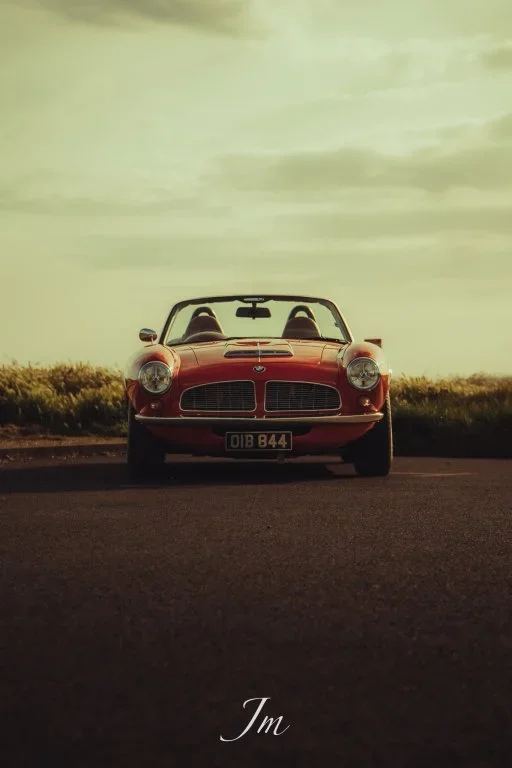

Recent photo shoot

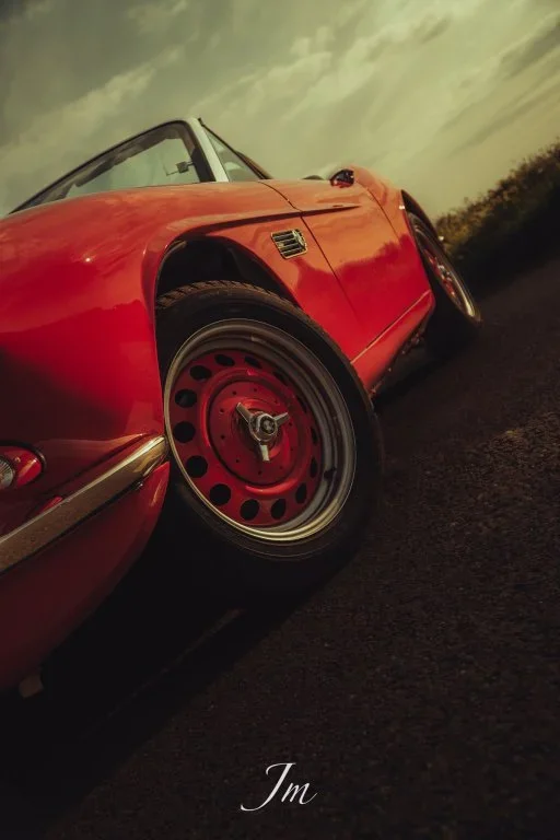

Wheels I want to replicate the Rudge knock offs.
I bought bmw winter steels and had them powder coated.
centre caps are Vw transporter sprayed red with plastic spinners off Amazon. These spinners are bolted on from the rear.
fitying the caps to the wheels isn’t straight forward as Vw use special bolts with oversized heads, and the bolt diameter is 2mm larger than bmw. At present I’m having the bolts turned down and new threads cut so I can use the Vw bolts. Fingers crossed this works so the caps fit. I will update when the bolts arrive

No issues I’m aware of. They have held up ok so far 👌
