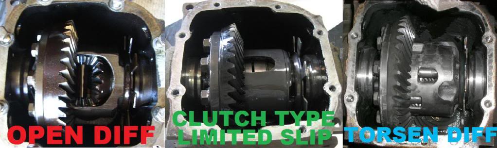

Top tip, when going to change your diff oil, remove the fill plug first. If it doesn't come off, don't drain the oil or you will never get the new oil in.
75W90 is the safe oil to use in the Z3 as it is correct for the open and Torsen diffs. True clutch pack LSD's use 75W140. True LSD's are a little rarer on non M Z3's as those with 25% diff lock typically having a Torsen diff. There are always exceptions.
The best way to tell which diff you have is when you are changing the oil, to poke a boroscope in the fill hole and have a look. If you don't have a boroscope, then beg/borrow/buy/hire one. See the photo of what you are looking for.
That's a great idea Murray :thumbsup:
Cheers lads. Will be checking these things next week hopefully fillholes come off. Ordering some penetration spray before do anything. Mate recommended blaster PB
