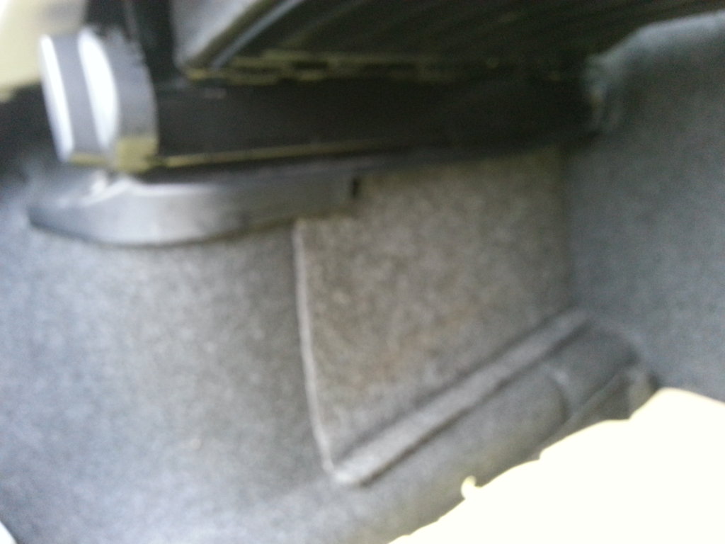

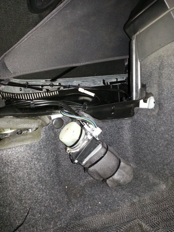

Due to the bad bmw design. roof motor failure is a common problem as they tend to sit in water when the drain holes get blocked.Resulting in extortionate costs of replacement of the motor.So to overcome this I've had the motor relocated into the boot . where ive got access to it .Why they put it down in the rear wing I'll never know.In the Z3 its sorted .So I went up to Durham this morn and had it sorted cost £120.only issue is the carpet used to form a cover is a different shade .But I can live with that .

Hi Redline, only took just under two hours, the guys done about 6 now so he's an expert, lol,
All the work is done from inside the boot so you need to be a bit flexibe, ha ha, Unfortunately im not otherwise I would have done the job myself, a little cutting is involved of the metal riser plate to the parcel shelf to feed the cables thro, an thats it ,
But tbh at that sort of price why struggle yourself, most others want a min of £250, and take the roof off , but that isnt necessary,

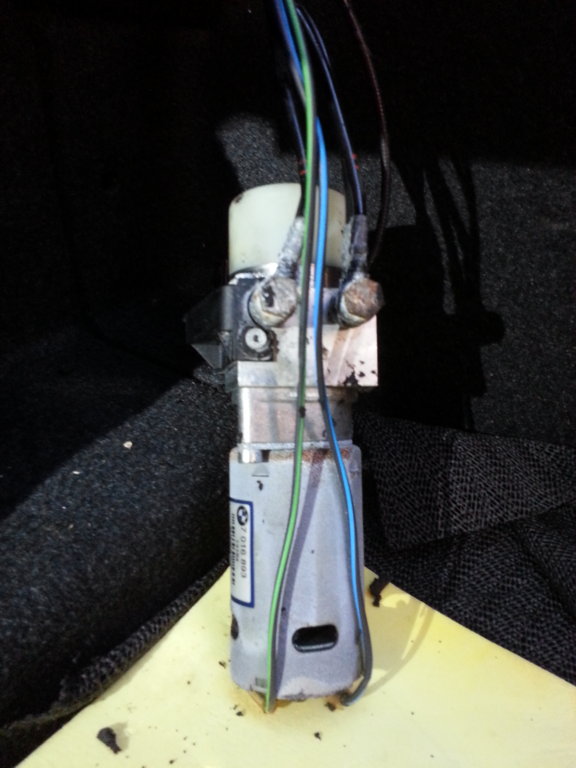

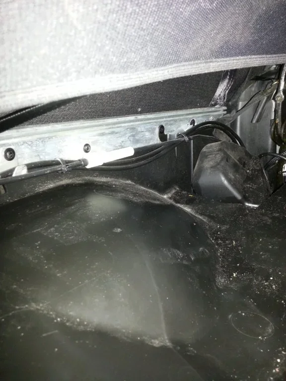

Hi Pete .if you ever need or fancy doing it will giv u a few pointers.parcel shelf comes out and the passenger side riser mechanism.
At tha same time its advisable to do the rear top mounts as to access them u have to do all that anyway . Another stupid fkn BMW design error.thats the motor in at the back in the black shroud.
