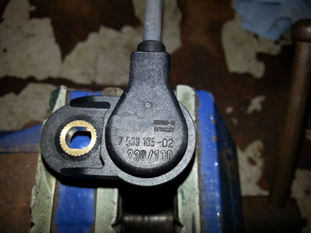

This is the one I purchased with the Bosch Logo removed but still has the part number on it 7 539 165 - 02 and made in Germany. Try Googling the number.

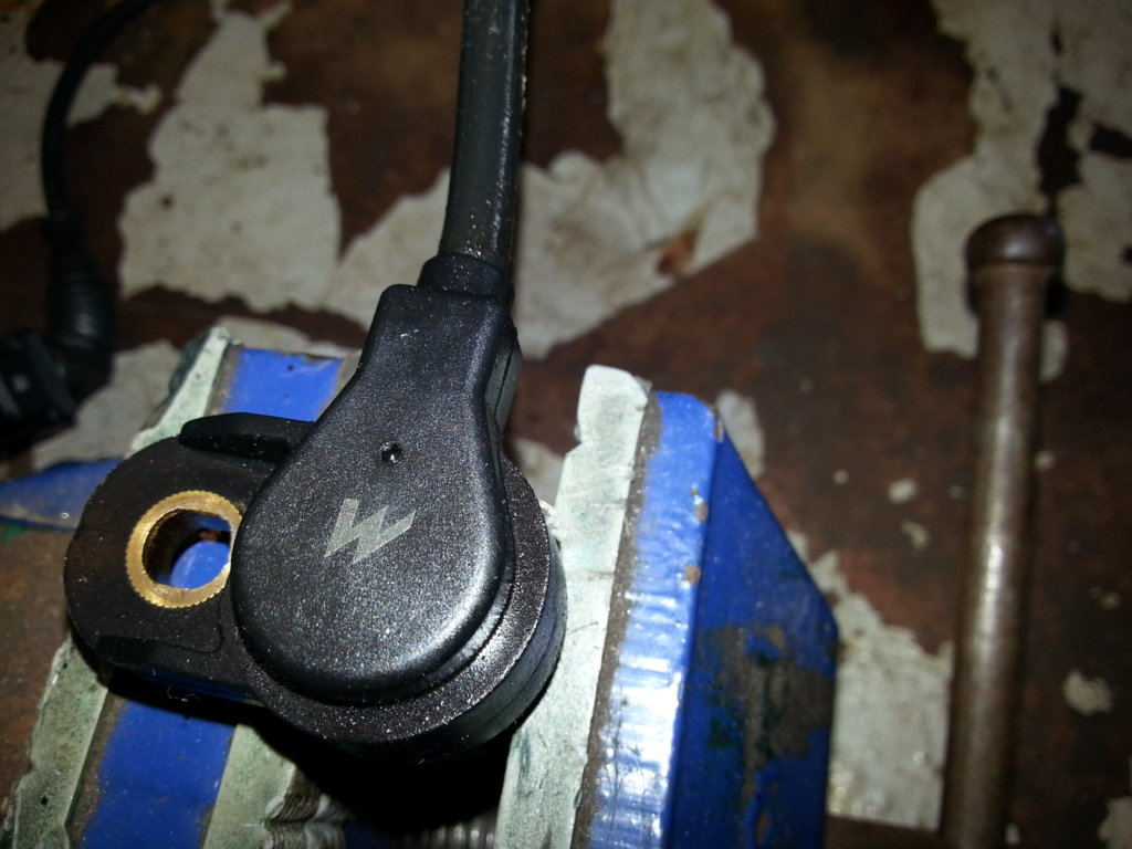

This the non-descript item I originally got from them (cheap crap) which lasted only a few weeks.

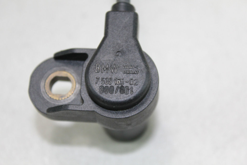

The part number 7539165 is the BMW part number. OE part suppliers will sell their own branded versions of BMW parts (well it's their product anyway at the end of the day) but not usually with the BMW part number on it. So I believe this is a BMW part with the BMW legend scrubbed out. This is the BMW part.
So it looks like Bosch has dumped some overrun stock on the market - possibly as a one-off. Of slightly more concern would be if they had failed BMW QC but passed a lower Bosch QC. I doubt it but I know this happens in the world of PC components.
