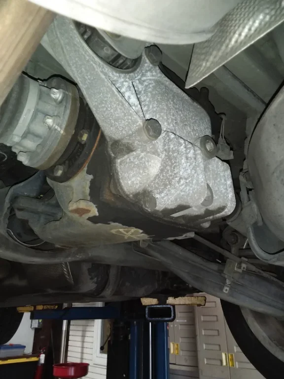

Hey, y'all. Got my first Z3 a few months back and have since noticed the classic "diff whine" issue. I found this single photo in a recent service record that shows the diff case is leaking. It was not addressed at the time of service. Being a newbie I'm looking for insight and maybe some encouragement! While I'm at it I have a question:
Based on the photo where does the main leak seem to be coming from?
My newbie eyes tell me it's the main gasket - but wanted to check with y'all before I start ordering replacement parts and potentially borrowing tools.

I would say one (or both) drive shaft seals. Oil wouldn't track back from the cover joint towards the front of car, unless it's been driven backwards at speed regularly :whistle:
But if the driveshaft seals were leaking there would be oil below the shaft(s). I would say it is the backplate gasket, but, I would clean it all down with brake cleaner and run it for a bit and re check before doing anything.
Fair point Tony, should have looked a bit closer :)

I swapped out diff the fluid this afternoon and sprayed down the entire area with brake cleaner. I'll check it every so often to see if the leak is still active at all.
Fingers crossed that the fluid change helps with the diff noise. I'll update the thread after a few hundred miles and let you know how it's going.
