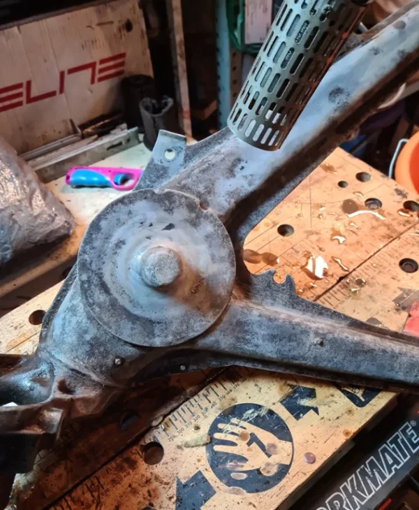

then it was onto coating the nearside trailing arm with POR15...this is in readiness for a couple of coats of Hammerite red oxide which I shall do tomorrow
POR15 coated and kept wet for 20 minutes, then washed off with plain water before drying with a heat gun
