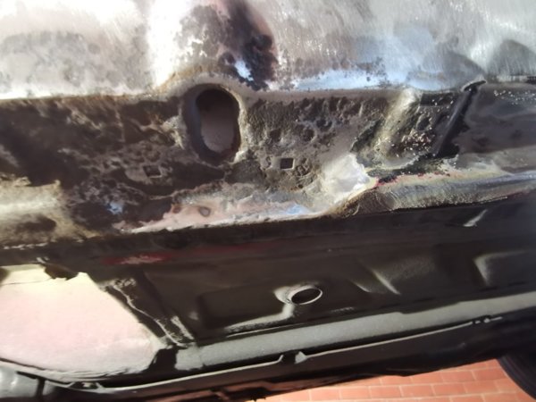

For the inner sills I started with all jacking points looking like this
